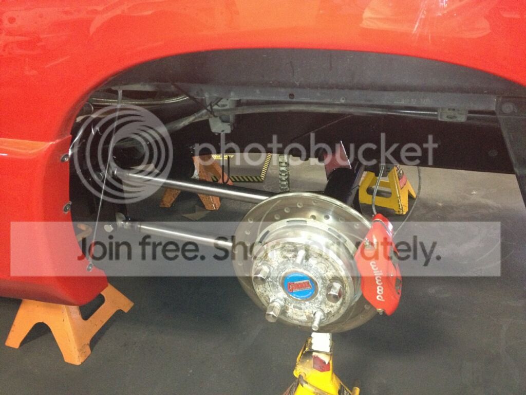

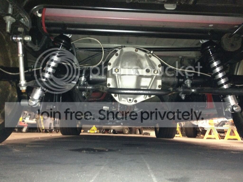

Some progress pics
ends of the bars are adjustable, and then there is the 3 notches on the axel for ride height adjustment
Yeah that'll give you ride height and pinion angle adjustablity but most 4 links have multiple mounting holes on the forward mounting as well to adjust where the suspension exerts its force on the frame
Ill have to check and see whats happening with the front of it, these pics are the progress, there is still the panhard bar and a couple things left to do to finish it up..

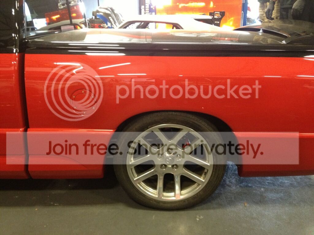

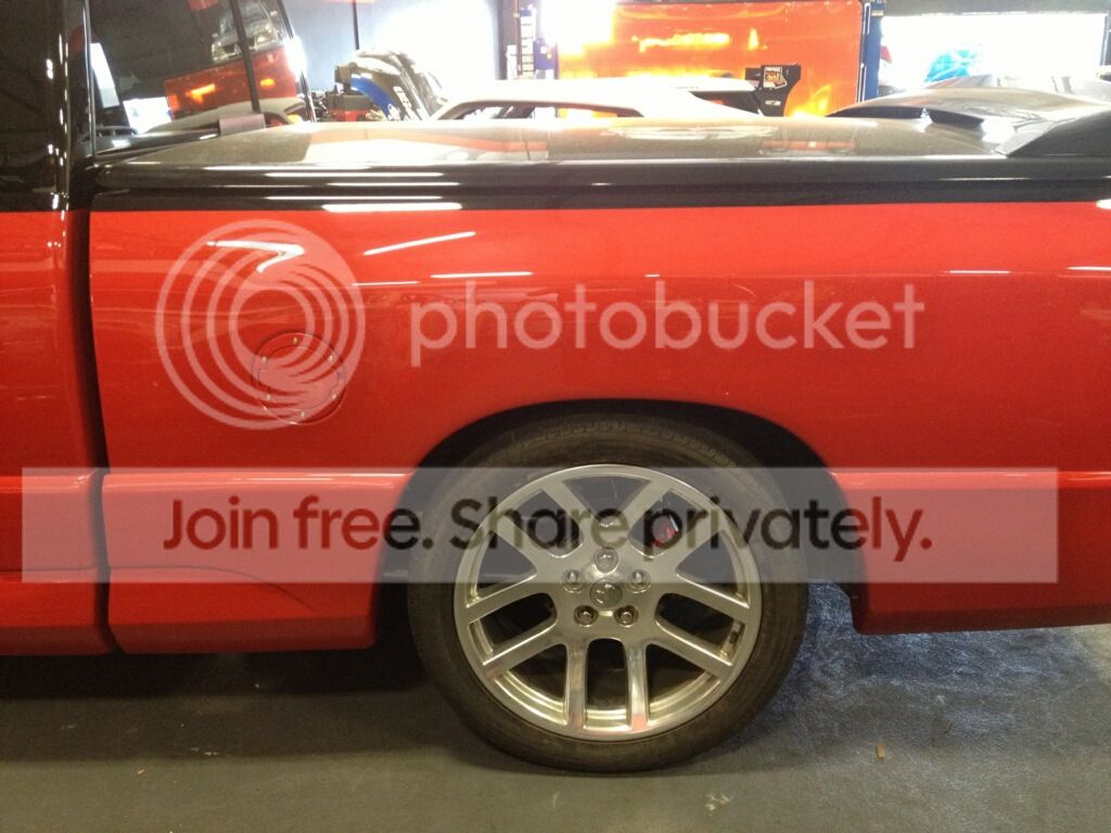

anyhow some pics below of the rear 4link that is now finally done.. Now we are just going to shave a bit off the back of the wheels and fold up the lip in the fender so they can clear with no rubbing issues..
4link
Lower setting
Upper setting
