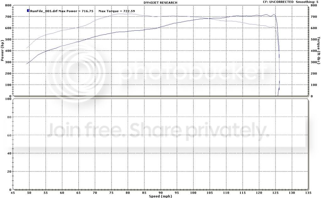

This was the glory run. It ended up not being one we wanted to run with.

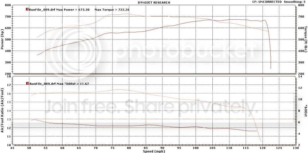

This is the safe drive it every day tune. Not to bad for a grocery gitter. We did have belt slip issues, so I still have work to do. But 722 ftlbs of torque is not to shabby.

awesome numbers i might have to get ur build sheet, thats bout all the hp i want
Awesome numbers Dale. Its gotta be the strongest Roe to date on motor and boost, specially on a QC. Congratulations!
Those are KILLER numbers for a QC!!!:rock: :rock:
Congrats Dale you deserve it.;) Just don't go too crazy I'm sure it will swap ends in a hurry now:( :D
