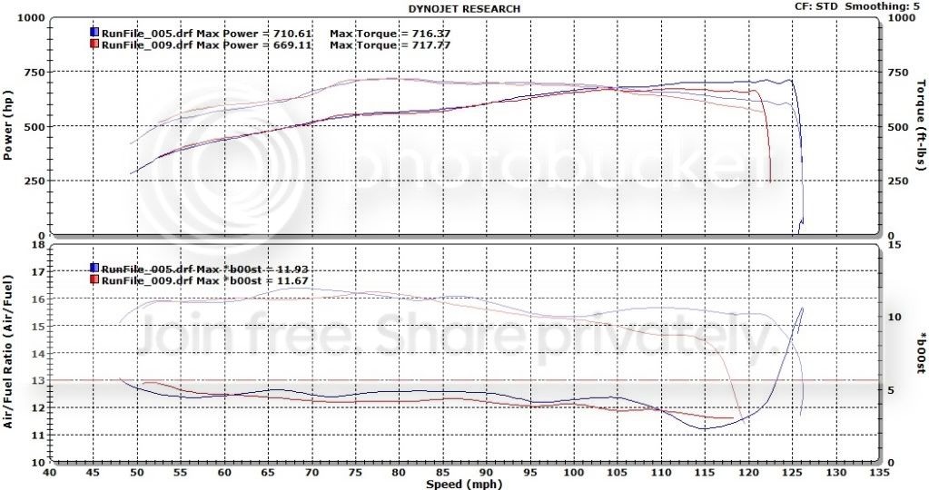

So todays excitement started when I could not get the computer to log in to the VEC system. We soon got that figured out. Then Sean identified that my log was not actually logging the AEM. Then we identified I was having belt slip issues. But we kept at it. We fixed the VEC log into issue. WE used the Dyno to log the AFR. And we just lived with the belt slip as it was fairly minor (only a pound or two).
The guys at Turbo Technologies did a great job with the dyno facilities. The engine built by JZB performed flawlessly.
Sean wants me to get the logging fixed as well as address the belt slip. Then I can log some more run time. A few little tweaks, and maybe we can get that safe tune over the 700 mark.

12.24 was the max boost on any single run. The normal max boost was in the high 11 range. However that quickly fell off a pound or so down to high 9 low 10 as the RPM's climbed. I have a little testing to do with my idlers. If the 100mm fits the top spot, I will order another one. I already have 100mm on the bottom.
You might not be so quick to assume that you're having belt slippage, you know. As RPMs climb, that compressor has to produce an ever increasing volume of air. A drop in pressure could well be indicative of hitting the ceiling on the Roe.
My first encounter on the dyno with the Paxton had almost everyone convinced that I was seeing belt slippage too. Obviously it turned out to be that I had run out of compressor.
Before you spend the time and money to address possible belt slippage, it might be worthwhile to consider that you've max'd out your blower.;)

These are very good points, and I welcome your experience. I do have some anecdotal evidence pointing to slippage. I have some black dust on the support. We saw varying degrees of boost drop depending on how much we had run it. There was less drop after a few runs than was on a completely cold run. The last thing is a noticeable slackness in the belt in its current configuration.
My first plan of attack is to change the upper pulley to a 100 mm unit.

how come the numbers are un corrected.....very good pulls none the less CONGRATS!!!!!!!!!! But corrected numbers put everyone on the same level that way you have comparisons!!!
The numbers were uncorrected, because I did not know how to use the software when I was going through the files.
Here is the STD conversion:
No, I know it is not the biggest HP. That honor belongs to others. But it makes me smile.

I too had belt dust and my belt loosened, even with the cog belt drive. These things will always happen whether you have belt slip or not.
When you say that you had less drop after a few runs, you don't mention if you're hitting the same peak boost. Also, it would be helpful to know how much of a difference in boost you're getting between the first and last runs.
What kind of results are other high performance build Roe users getting?
Fix the slip (your losing 2+ #'s past 5k rpm) and you've got consistent 700+ whp no problem. Congrats!!!
