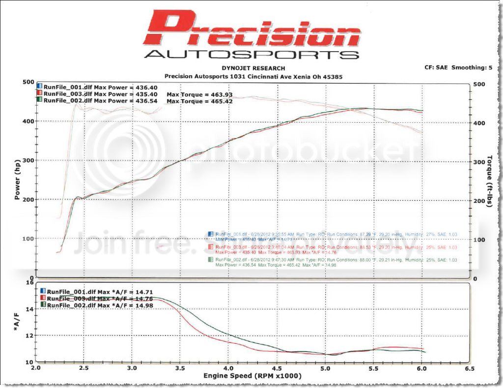

I dyno'd my 06 last month. The only "weird thing I see is a slight dip around 3300 RPM. Is that normal for a stock tune?
Your problem is your air/fuel is in the 11,s and almost hitting the high 10,s ,,you need that air/fuel to be 12.5 or so on WOT
