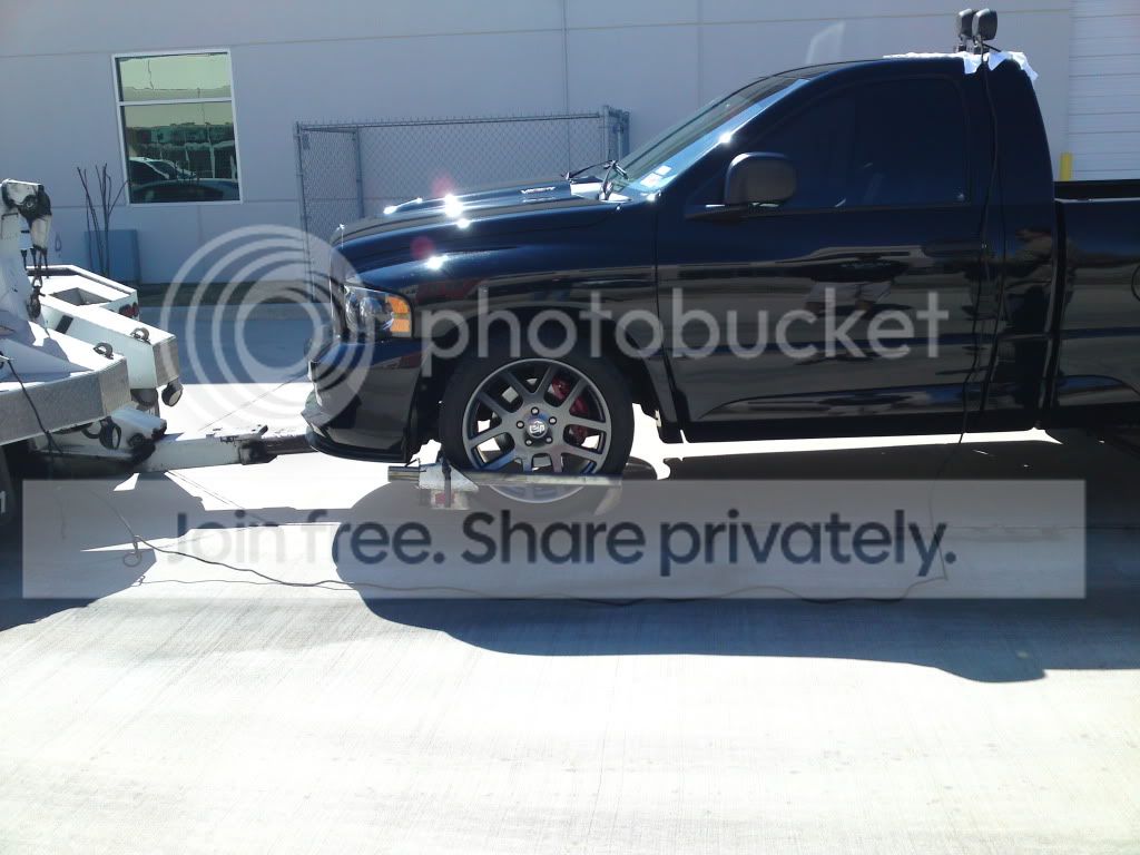

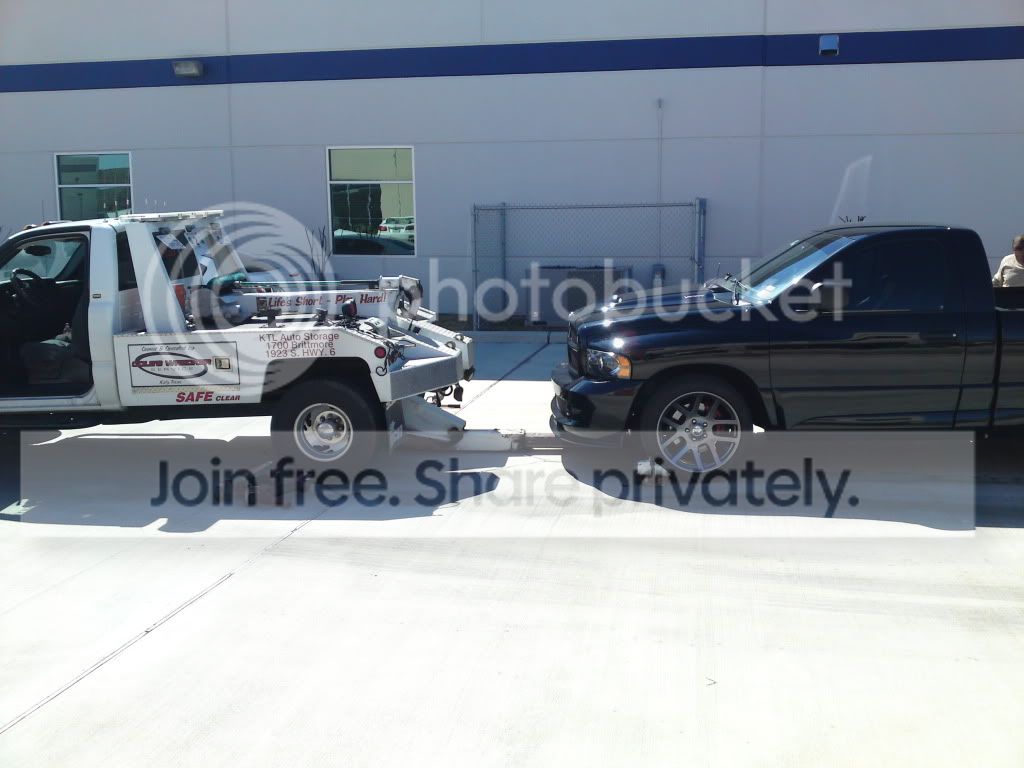

Well is seems that my engine was hydrolocked due to water getting sucked into the intake. Im still puzzled at how so much water got into my engine but they are dropping the oil pan today and I will soon find out whats sitting on the bottom. I turned the flywheel with a screwdriver and I did see water stream out after it went through a compression cycle :mad:.
[/IMG]
There she goes :stickyman:
Never seen anything towed like that before. :dontknow:
