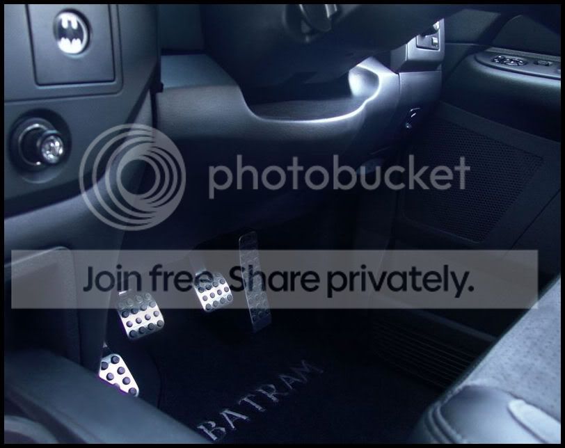

One question, is that third foot peddle from the clutch or the foot brake?

e brake silly!!!

As Dom kindly pointed out, it's the e-brake lol. I did that while it was manual, I had an old shitty clutch pedal cover that needed to be replaced so instead of throwing it out when I got the new one, I cut it down/filed it to size and made the "complete set". If you want to do the same call the wreckers and get them to send some used/worn pads, a cheap and easy mod.
