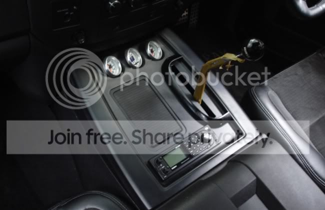

Well, the front half of the console is 90% complete, taken longer than expected due to money, parts delay and having several other jobs/work needing to be done on other vehicles/the house, but, no rush though. :) A few things to fix up, only small misc fitment issues but apart from that it's done. I wanted it simple, clean, subtle and like a factory option. I think we achieved that. I'm over the moon just to have it done. The rear console part has been chopped down to half it's size. I've never been a fan of that mini pyramid between the seats lol so, it'll be a custom made low profile thing, similar to what you see in the photos below, albeit that's just the old lid there for mock purposes for these photos.
I'm taking the truck to a show I organised this weekend then it's back to the shop next week. Any questions, just ask, here to help or try my best. One of the coolest mods and one I'm over the moon with is the AMG Mercedes paddle shifters. They kick arse! ;) Lots of other little mods but the main one is the console. Thought I may as well post an update now since it's still 1-2 months away from being complete as I have other jobs on the go that need cash. Sucks being broke LOL. Anyhow, enough chewing the fat. Once it's fully complete, I'll have every mod I did, and those I tried, on my website. Until then, this will have to do.

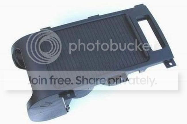

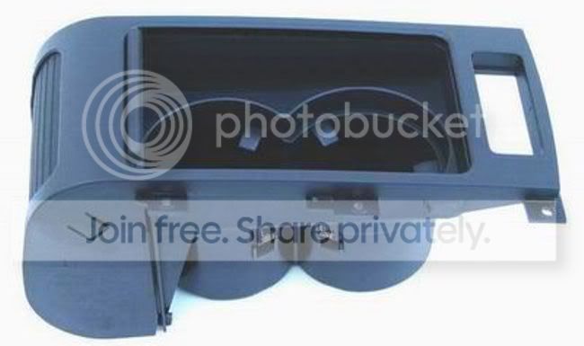

The BMW Cup holder I chose. Need cup holders, but didn't want anything ugly, this hidden unit is just the trick IMO.
Cup holder tray pulled back/open.
Getting there...........

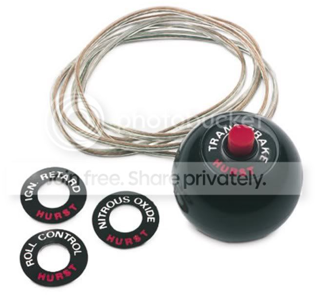

The shifter I chose in the end was the Hurst Promatic-2 Truck shifter.
The Hurst Ball shifter controls the Carl Rossler transbrake.
How it looks today, close but not quite there.
Another angle.

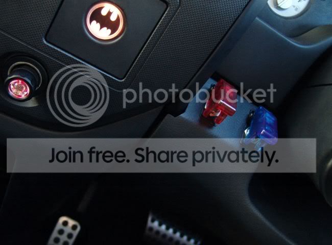

The blue switch engages the transbrake (safety, when it's off I can touch/bump the shifter button, nothing will happen).

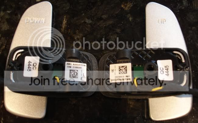

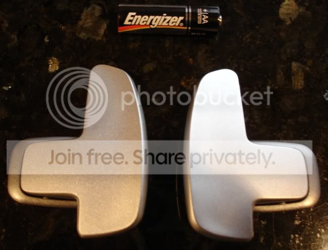

The AMG S63 Mercedes Paddle shifters, real top quality, they weigh 0.2lbs each, nice and solid!
The guts of them..........
In place. :rock:
Left = down shift.
Right = Up shift
From behind......
