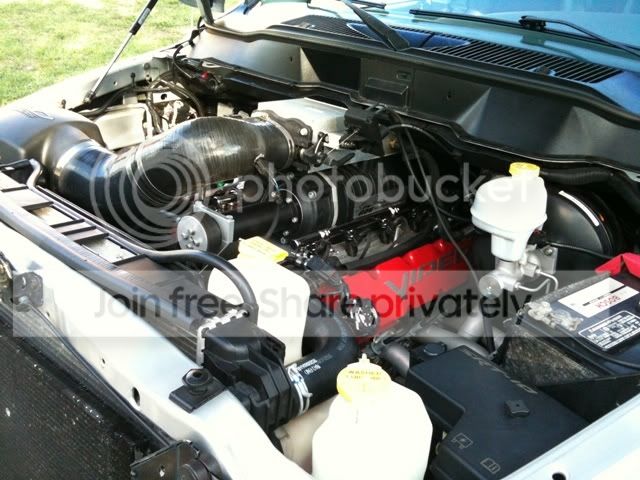

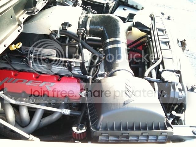

UPDATED PICS, I will post up gauge pod pics once I am done with the gauge install.
