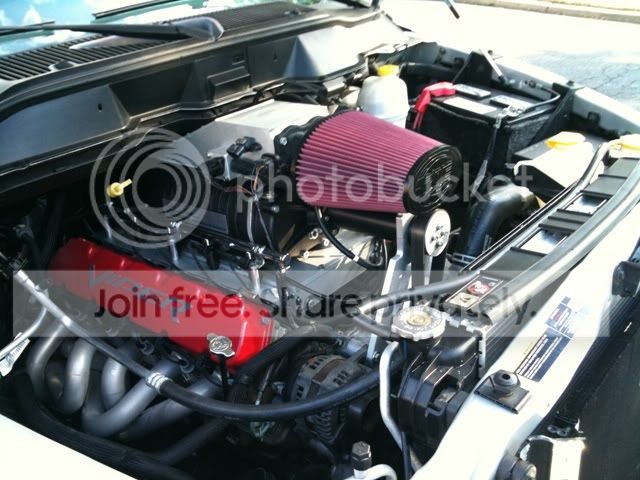

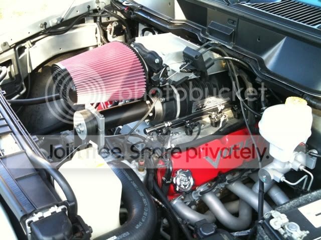

Here of some pics of where im at in the install. working on water/meth next. Can anyone tell me what generation Roe setup I have by the pics?
Looks good, no heat shield for the air filter? It looks like the 3.3L Lynsholm supercharger someone esle should be able to verify that me.
Edit just noticed no breather filter and hose coming off passenger side?
Waiting for the paint to dry on the heat shield. Did not like the silver color, painted it high temp black. Pic was taken before I installed catch can.

Oh ok, where you IAt temps taken without the shield in place? If so they should drop. Which catch can did you go with?
Some of the pcm readings take 40 to 60 miles to register, so a little more driving is required...I have never used my heat shield...it is sitting around here some where, I think.
I think you should spring for a breather on the drivers side (get it from Sean) and I have my catch can receiving from the rear of the drivers side...you will note that the pressure from the passenger side rear vent is minimal (because engine rotation direction is toward the drivers side).
Breather in this pic:
Catch can in this pic:
