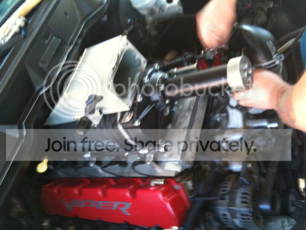

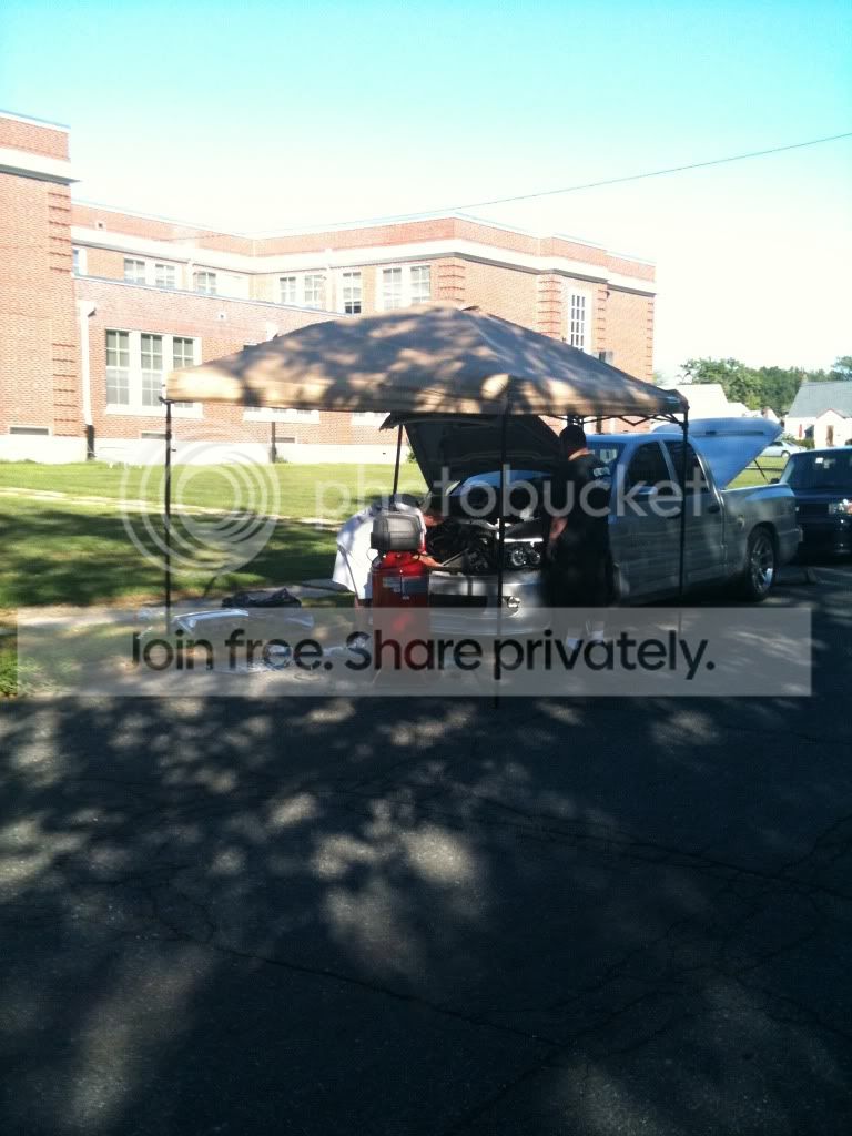

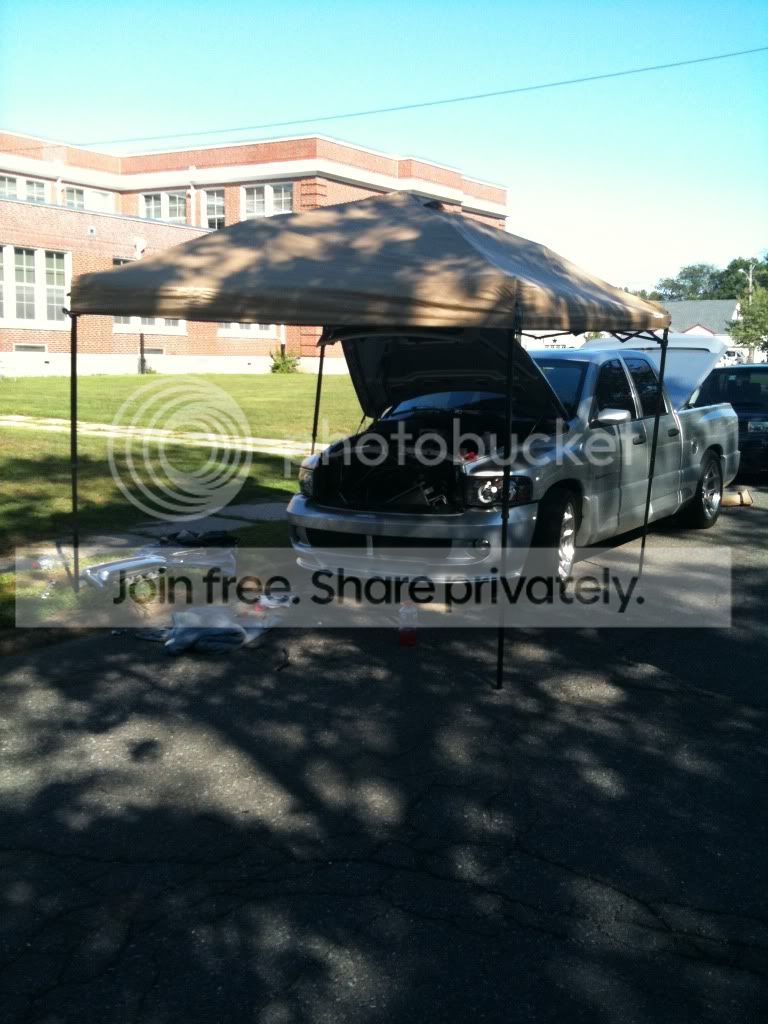

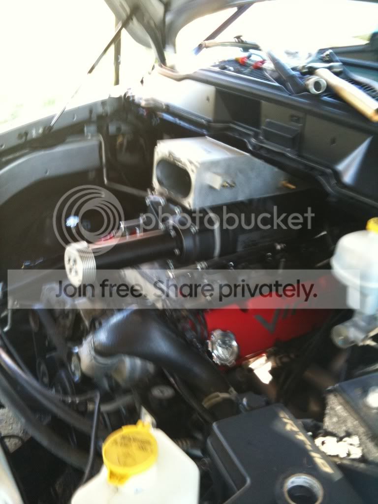

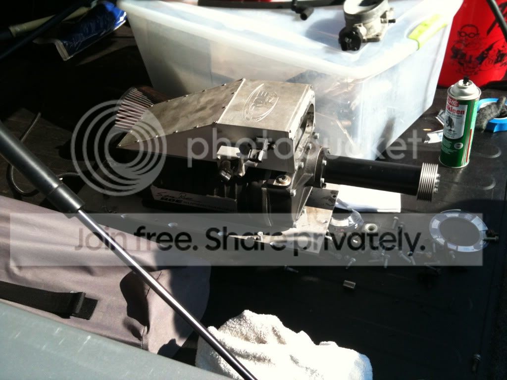

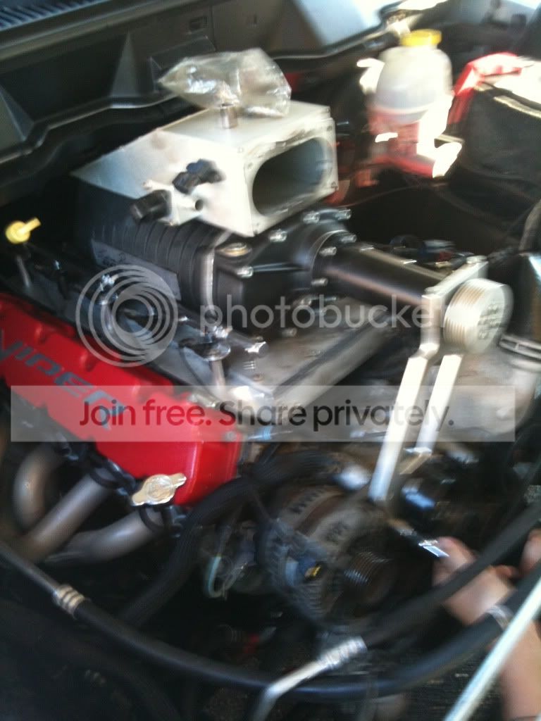

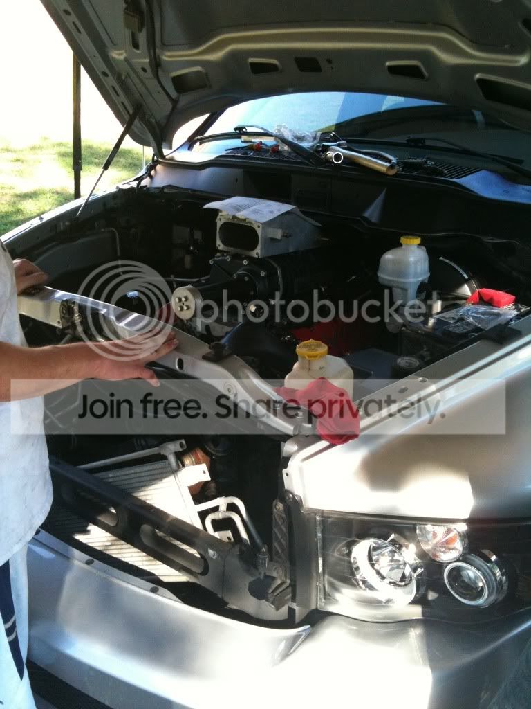

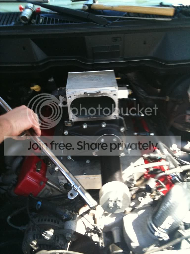

i ment up with Rick over the weekend to help install his Roe, here are some pic's
Rick is a super cool guy, and also Rocky came over repoman awsome to know there are other ppl in jersey that dont mind getting there hands dirty
ill post up more pic's tonight when i get home from work
